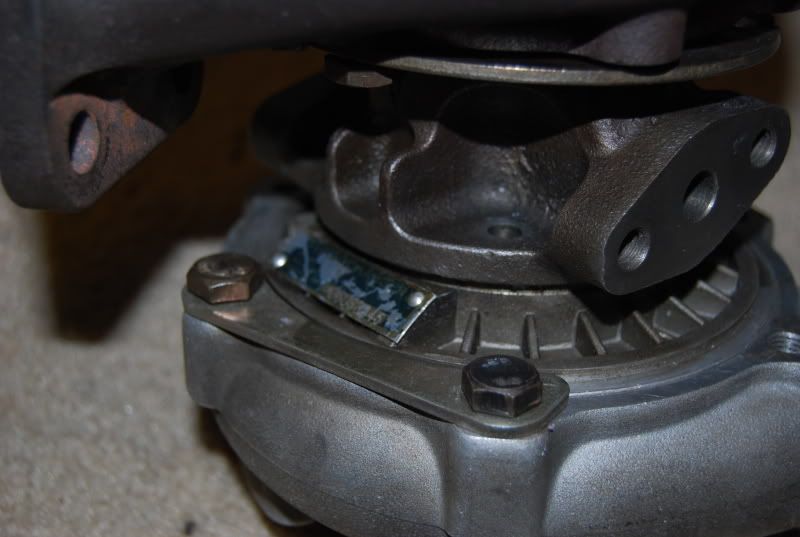

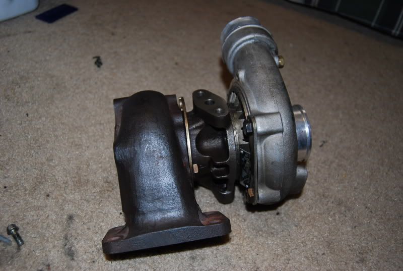

    2 full shots of the Turbo pre-tear down
    Compressor side housing clamps;
    Remove the two 9/16 or 14mm bolts on each section to free the compressor housing.

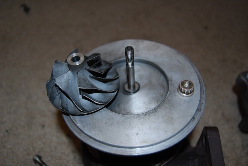

    You will then be left with this;
    You will then need to remove the four 8mm bolts under the compressor housing disc;
    Using the closed ended side of the wrench to break them loose then the open ended side to fully remove them works best.

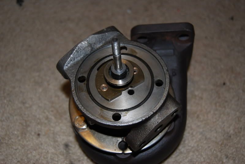

    There is a spring lock washer that sits in a groove that must be removed;
    This was honestly the most difficult part for me as I did not have the proper tools to remove the washer
    I know they make pliers that have little tips made for removing these but as I did not have any a pair of tweezers a .050 hex key and a set of needle nose pliers made do. I would NOT recommend this method.

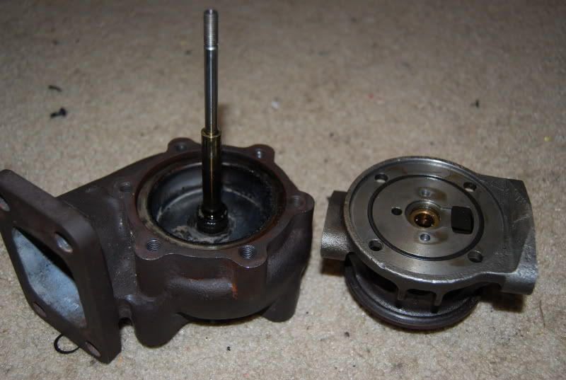

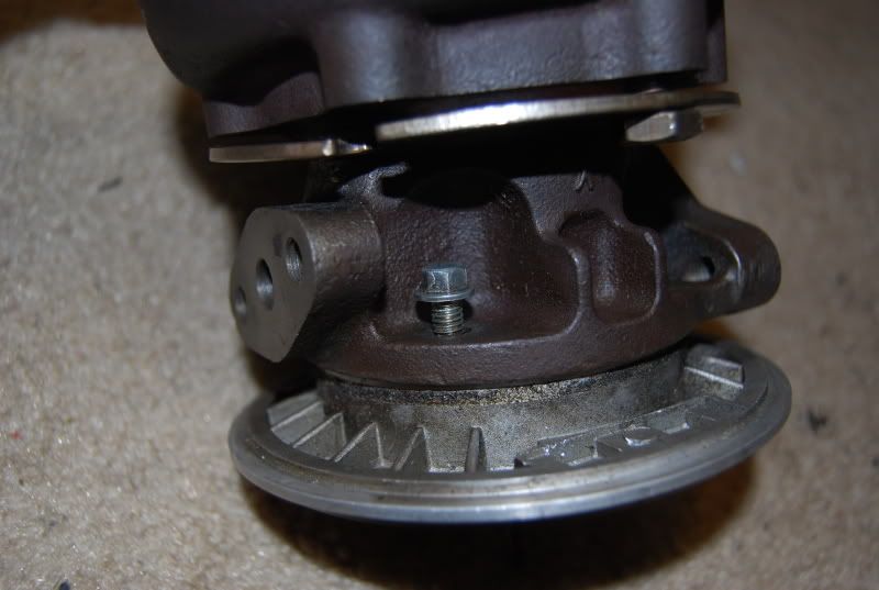

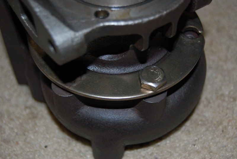

    You will then need to remove the turbine side clamps.
    Same size as the compressor side clamps 9/16 or 14mm

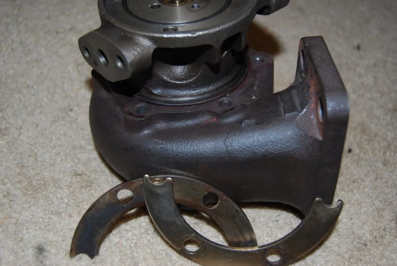

    You then remove the actual CHRA or Center Housing & Rotating Assembly by pulling it straight up, you will then be left with this:
    You then pull up on the dish like tray, and remove it;

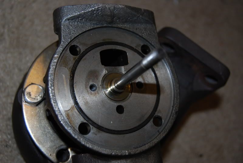

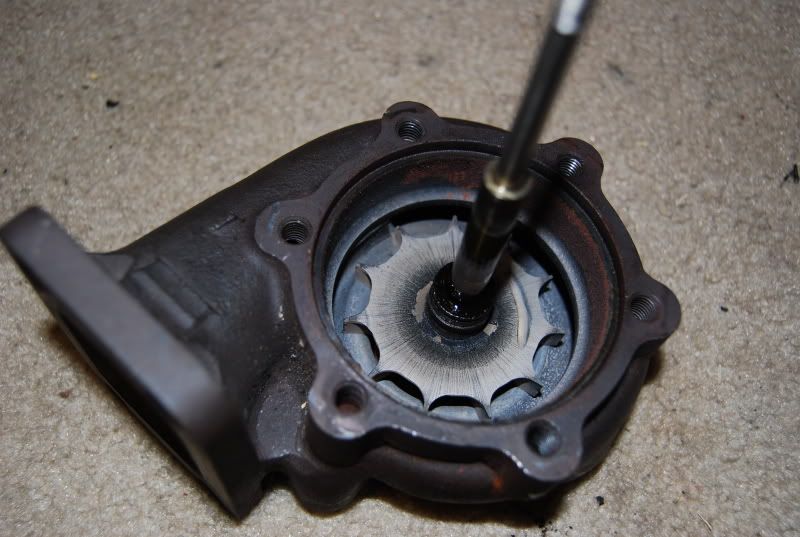

    You then simply lift the turbine wheel and shaft and you are left with this;

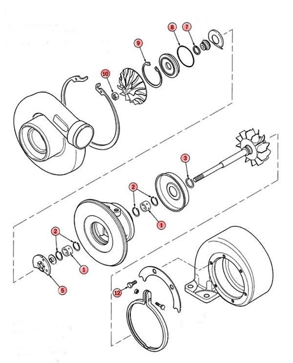

    To reassemble a turbo (if it's used or worn out) you'll need a a Turbo Rebuild kit ,this is a good picture of it and what one consists of:
    #1 Journal Bearings
    #2 Retaining Rings for Journal Bearings
    #3 Piston Ring for Turbine End
    #5 Thrust Bearing
    #7 Piston Ring for Compressor End
    #8 O-Ring for Bearing Housing to Seal Plate
    #9 Retaining Ring for Seal Plate
    #10 Locknut for Shaft
    #12 Bolts for Turbine End
