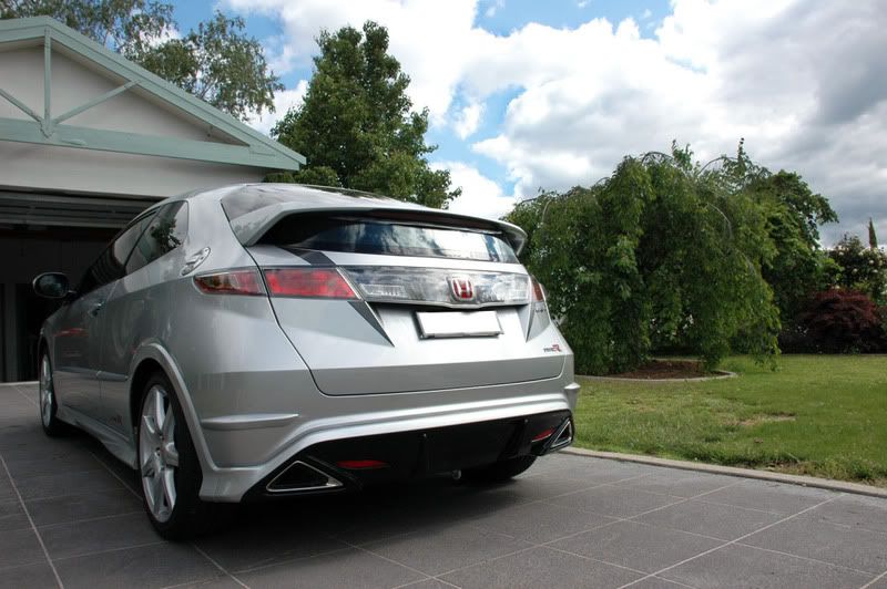

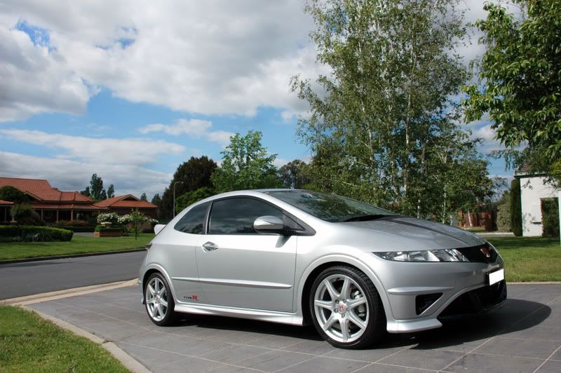

    To start. We bought the car new back in 2008 at our local Honda dealer. Went through the catalogue and got just about every genuine accessory they had.
    OEM Front and Rear Splitter Kit
    OEM Type R Emblem Kit
    OEM Bluetooth kit
    OEM Floor Mats and Boot Tray
    OEM Accent Interior Light kit
    This is how she looked not long after we picked her up.

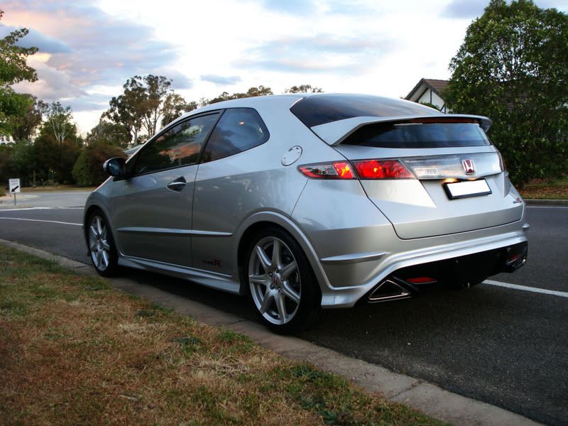

    After having her for a few years and only doing 2500km, yeah you read that right. Honda japan released the car for a limited run in 2010. Mugen finally then got their hands on one and started to bring out parts for it. Having had a few mugen parts on my previous cars i just had to have more.
    Our first ever mod and also our fist video was the Mugen Cat Back exhaust. I drove to melbourne about 350km and back again, only a 15min break in between when we picked it up. Then i fitted it all up.. all in one day. I rock It didn't give us a power increase as such, but man it gave a good note.
    Then next mod to take place was the JDM RRC Manifold. The Japanese Type R (also known as the FD2) has a different manifold to the European model, and because it just fits its a good upgrade, larger diameter and straighter piping, plus no big baffle on the bottom to suppress the noise and rob us of power. We also fitted a gasket that stops heat soak to the manifold. It gives a sound sort of like ITB's (individual Throttle bodies) It sound soo nice. the manifold just fits in there.. i can't even fit my fingers in between the manifold and the radiator support. it doesn't hit but its close.
    Next up we put on the Mugen Hi-Performance Intake Kit. In short a new air box and cold air feed. This besides the exhaust was my favorite mod. The vtec sound is just amazing, it kicks in good and gives the aussie cars a real scare. We waited for 4 months for this to arrive, But it was so worth it in the end
    Last engine mod was the Mugen Throttle Body. Mugen bored them out to 68mm from 65mm standard. this means better flow and more air can be crammed into the manifold, it also is a good match to our manifold as the intake for that is 65mm. this is one of the most rarest mods we have. Mugen don't sell these to the public any more, so we were very lucky to get one.
    So now your thinking how did you get all of this to work together? Well we had to flash the ecu to accept the mods. It will run perfectly fine without a tune, but whats the point in doing all this to not get the full benefit from the mods. We bought a flash kit and got a tune done after every mod we did. We moved vtec down to 3800rpm, but the car was very on edge for daily driving so it was moved up to 4300rpm and redline at 8500rpm. you might think thats high, but the original vtec kicked in at 5400 and the redline was only 8000. it was a big improvement. My friend who owns an rx7 was very scared when we took him for a drive last.

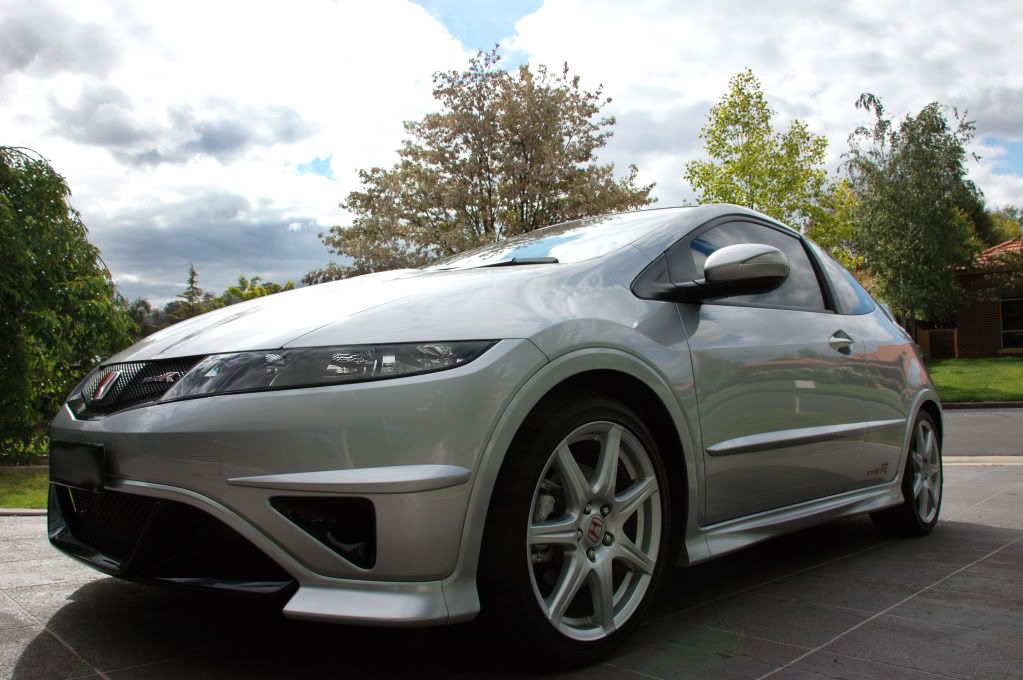

    So this is how she looks now. We've also put OEM racing stripes and the fog light inserts that got put on with the intake kit. Engine has also been dressed up with a Mugen Coil cover made in Dry Carbon, mugen oil filler cap and radiator cap.

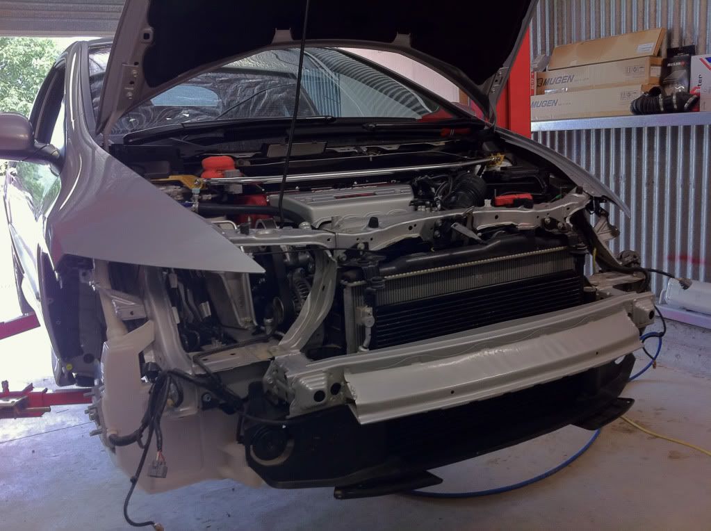

    Alright so this one was one of the bigger jobs. This time we fitted up the J's Racing Fender Brace kit. To get this done the whole front fenders had to come off. Performance wise it increased rigidity in the front end. J's Racing Claim that the FN2 has twisting around the wheel arches so by putting the bracing on it helps with handling. there is a definite increase in rigidity the car is very much point and shoot.

                So we recently got a whole heap of parts from Japan. So over the past 2 days i have been working on the car. Ah how i missed the cuts and bruises... especially the one on my eye, the engine support brace decided it didn't need to be on the car any more.. ah well. so here is a sneak peak from today. Not sure when we will have the next video up, but i now have heaps in line.

                      @upamanyu Yes thats my own garage. I have everything i need in there, and because its out of town, i can make as much noise as i like at all hours of the night
                      @rosey... Ah.. a little more extreme than a bumper i had to take the front fenders off to fit this, plus a heap of other bracing and a very very pretty exhaust manifold.
