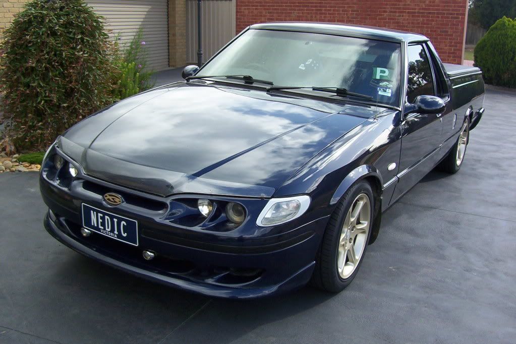

    Anyway I though I would Share my Project ute that I'm very slowly building up.
    I've had the ute about four years and was my second car.
    This is what it used to look like:

    Wow, not a fan of Ford's but that's a mean looking Ute, and it can hold its own by the looks of it too. (Or will be able to :P) Much fabrication work needed to fit the 33 box or is it a relatively easy swap?
      very nice. i do love this model of xr
      "Is it weird this gave me a Rageboner?"
        Hmm this car confuses me... it's almost like an EF falcon with a HQ Kingswood lobbed on the rear end heh.
