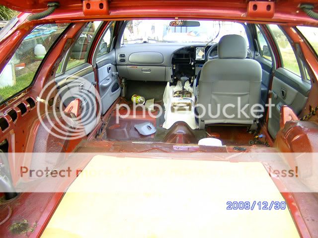

    Since finding MightyCarMods, viewing almost every episode and being a modder of sorts I thought I would do the whole build thread here for your perusal.....
    My '94 ED Falcon wagon started life as an ebay purchase for $510.00 back in May 2008. The car was located in Bennetts Green on the NSW north coast and with a couple of friends for support I drove it back to Riverstone in Sydney's West. That wasn't without its dramas along the way, like the auto spewing out horrible amounts of brown liquid along the way:
    I just made it home before the auto pretty much expired.
    Over the next few months the task was to get it running reasonably well. My whole purpose for buying it was the body, it was straight, good paint and absolutely no rust. After an initial engine and transmission change it stayed original until about Nov 2008 when it all started. You see I had a painful diff whine in the car and needed to get another to fix the problem. I did that getting an EL diff off ebay for $400.00. The bonus was that it had a whole car attached to it

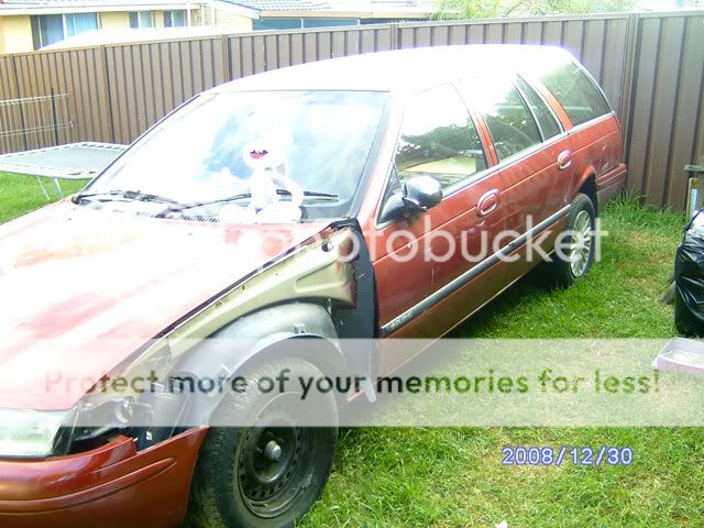

    The donor car was a '98 EL Wagon that had had a shunt in the rear, enough to bend the chassis rails and rear panels. Funnily enough it didn't damage the tailgate or taillights as the car has a monstrous Hayman Reece towbar that took the brunt of the collision.
    I parked the car in the backyard (much to the delight of my lovely wife - NOT!) and it sat there for a time while I decided what I was going to do with it.

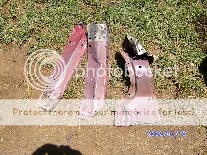

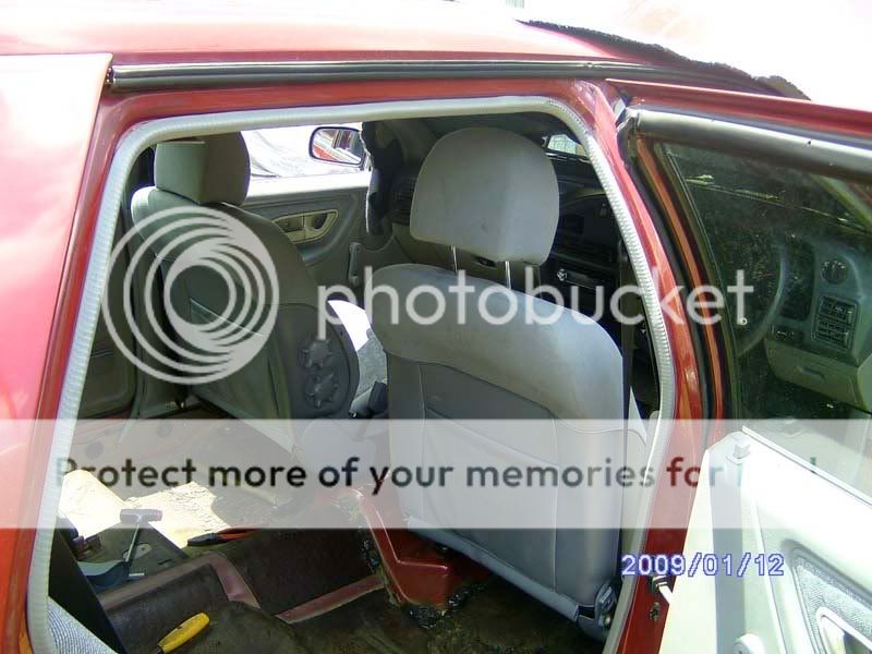

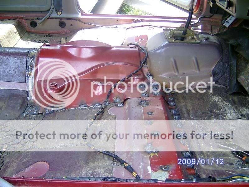

    The first thing I wanted to do was change the seats over from the EL (because the ED seats were crap!) but struck a major obstacle - the EL seats frames were different from the ED. Now I could have take the road of modifying the bottom rails to fit into the ED but I wanted more seat options in the future and did not want to modify each and every seat I wanted to put in. A closer look at the EL revealed they had a secondary floor in them that contained the seat mounts. So I set about drilling out all of the spot welds until I had this:

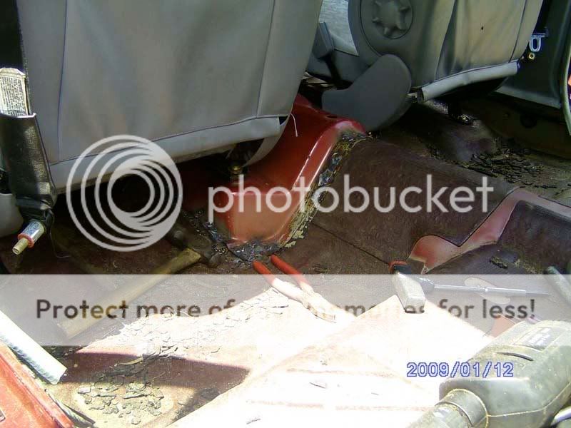

    This is how different the ED was compared to the EL:

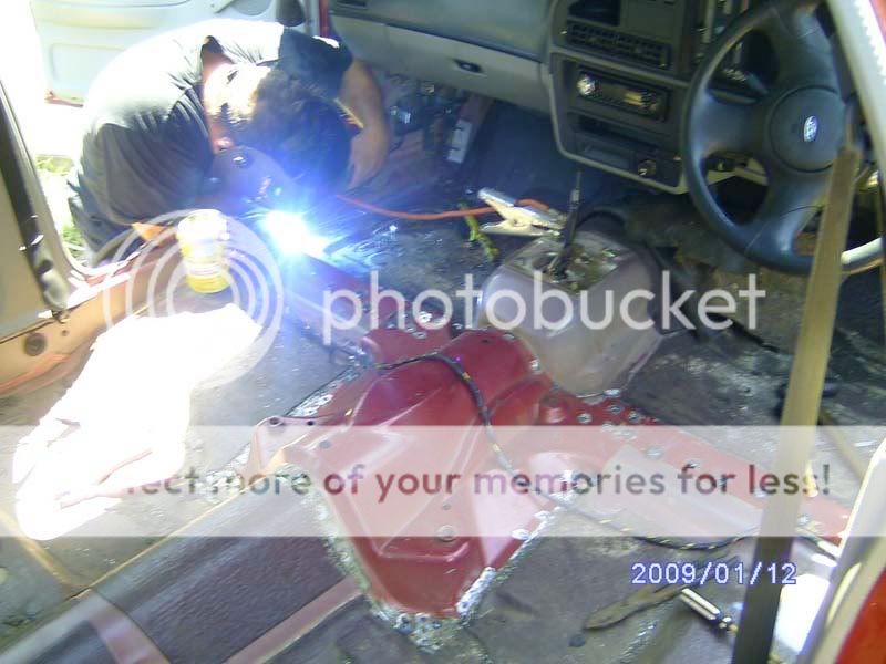

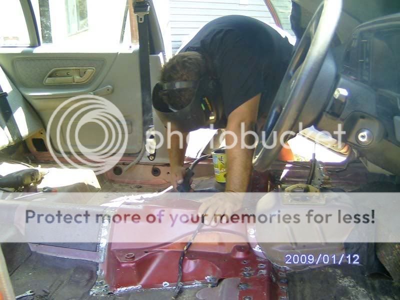

    I then conned a mate over together with his Mig to rectify the seat mount problem:
    ED seat mounts removed:
    EL Seats mounts being welded in:
    All done:
    And with EL seats fitted:
