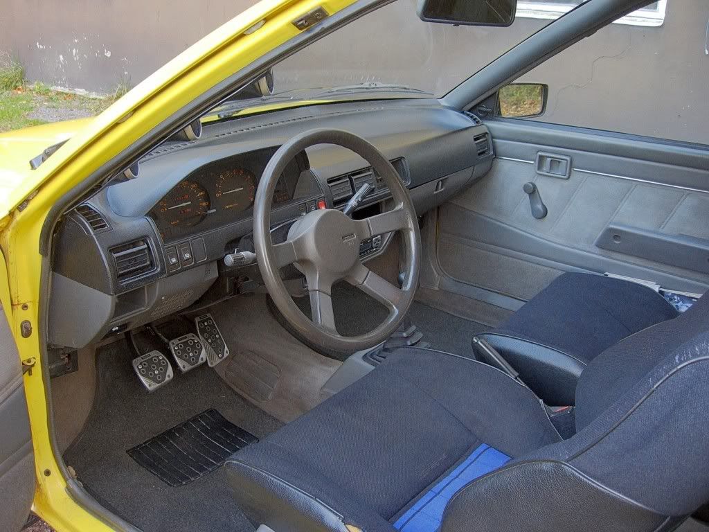

    Interior photos:
    The gauges are: oil pressure, water temperature, battery volt meter. No 52-mm clock or fake gauges here, all of them are connected and do work properly! I replaced the original blue-gray interior with a gray/black one in 2006, and during the body restoration I got my hands on a set of Turbo/SGL seats. Those sport seats don't come factory equipped with seat heaters so I took out the heater elements from my original seats and installed them into the sport seats. Had to use the sewing machine to be able to install the seat heaters because the seams on the seat and backrest unfortunately didn't match up with the seat heater elements. The seats will need a new set of upholstery later, especially the driver's seat.

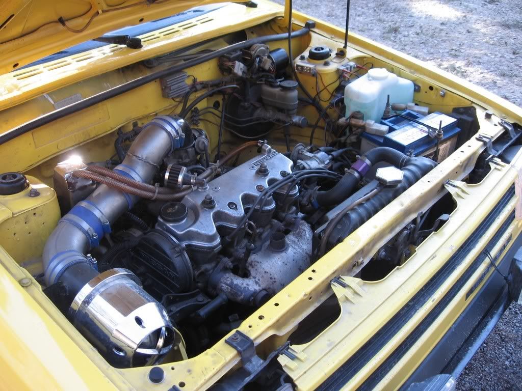

    Engine bay:
    (sorry for the dirty engine bay, I forgot to take a photo of it while I was taking photos of the car a couple of days ago so this photo is from April)

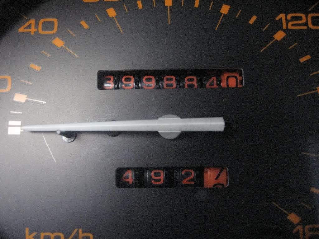

    Current odometer reading:

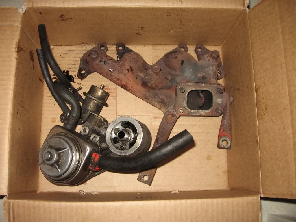

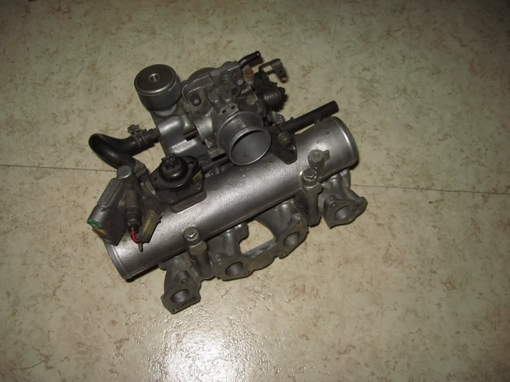

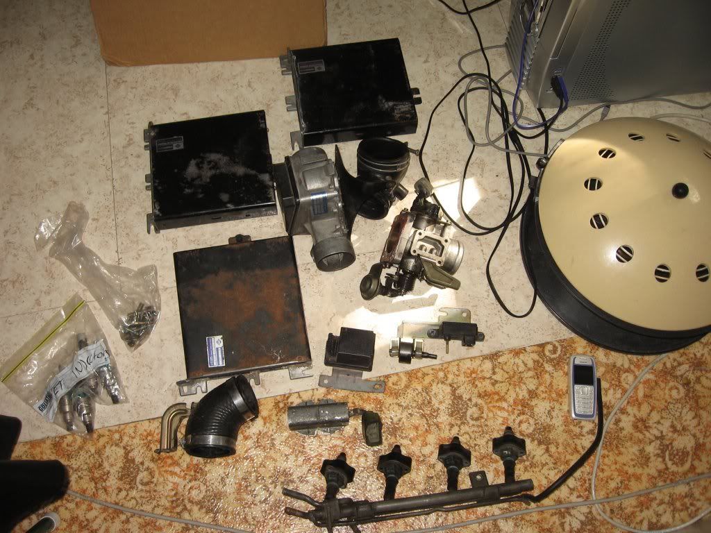

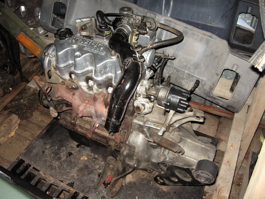

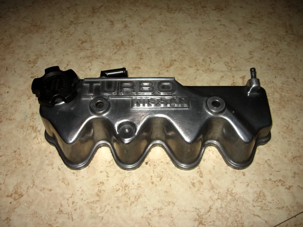

    During the restoration, I started another project for this car: a factory-spec EFI Turbo engine conversion (Nissan E15ET) from bits and pieces, based on the original engine which will be rebuilt. This project includes replacing the gearbox, flywheel, intake and exhaust manifolds, the fuel tank, the loom, installing the factory Nissan E15ET ECU (carb engines obviously don't have an ECU), replacing the pistons for E15ET ones, replacing the piston rods for E15ET ones (they are shorter, and the E16 carb engine happens to have the same rods) to lower the compression (IIRC the factory compression for the E15ET engine is 7.4:1), etc. etc. I haven't quite managed to collect all the necessary parts yet, but it's getting there.
    Factory specs for the E15ET:
    Power output: 85 kW @ 5600 RPM
    Peak torque: 157 Nm @ 3200 RPM
    The original E15S specs:
    Power output: 55 kW @ 5600 RPM
    Peak torque: 121 Nm @ 2800 RPM

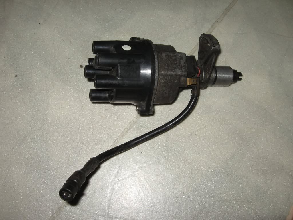

    Some photos of the project engine (the parts are dummyfitted, the engine still needs an E15ET flywheel and gearbox, a full set of gaskets and an engine rebuild):
    3 ECUs, AFM, injectors, and other E15ET parts from Australia:
