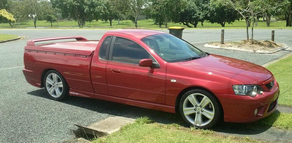

    Here it is after driving it 1000km from Brisbane to Mackay when i bought it. 2007 Ford XR6 Turbo Ute. In Seduce, 6 speed auto and all interior options.
    Look at that massive 4x4 ride height.

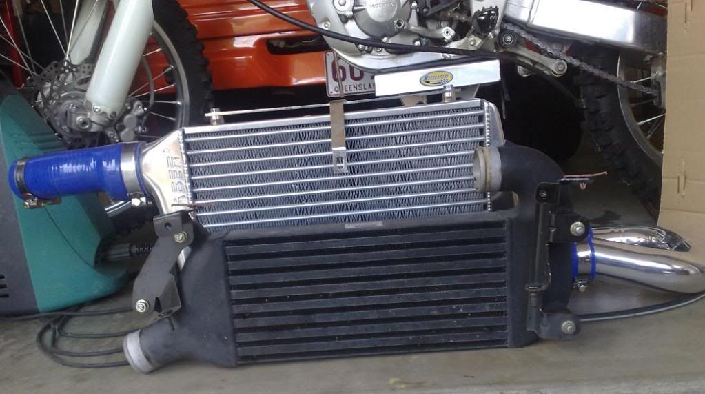

    Before i had bought the car home i had a front mount waiting at home for it. Was on special and what i wanted so jumped the gun and bought it.
    Compared to factory cooler.

    Then i bought a few things. I replaced the 17inch wheels with worn out front tyres with factory 18inch wheels with good rubber. 1 inch lowering blocks went in the rear at this time as well.
    I had also been slowly peicing together a hardlid setup and got it painted by a spray painter friend.

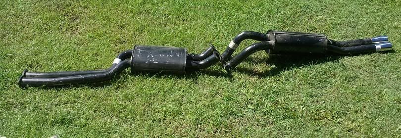

    Not long after i bought 30mm Whiteline swaybar and a twin 2.5inch catback exhaust. I fitted 3 inch tips in same style as factory ones.

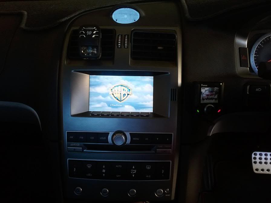

    For my B'day my Gf bought me Ipod video input for my car. Was all plug and play. It tricks the car into thinking your just using factory sat nav. I mainly play music videos on it but people have watched movies on longer trips. Usually blows people away when they see it. One of my fav mods on the car.

                      Hi, how much did the ipod video kit set you back, and where did you get it from?
                      Cheers
                        I got it as Birthday present from GF. Company called ASL automedia makes the kit.
                        Not cheap at about $400 from ASL
                        http://www.asllogistics.com/catalog/...Kit-p-219.html
                        We bought it through Universal Fuze. Same product, cheaper price.

                            Thanks for the response mate, just wondering is it only compatible with an iPod or iPhone or does it have different connectors?
