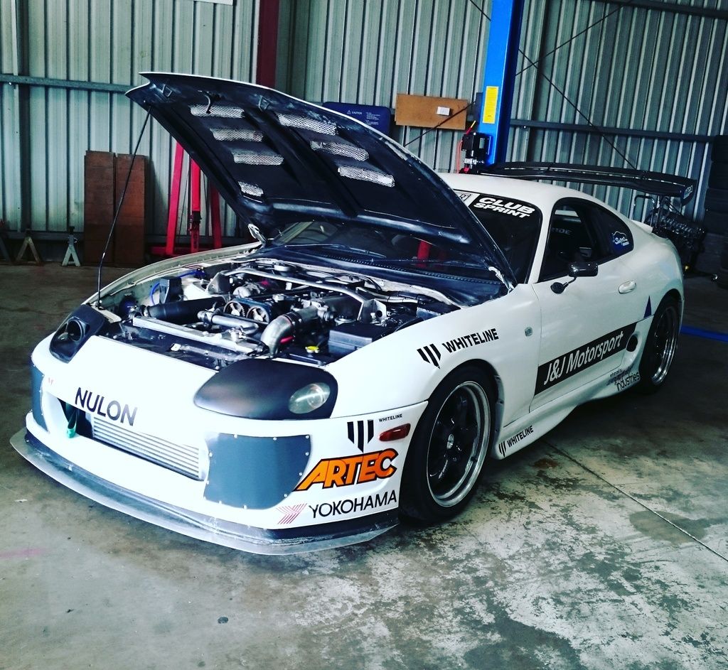

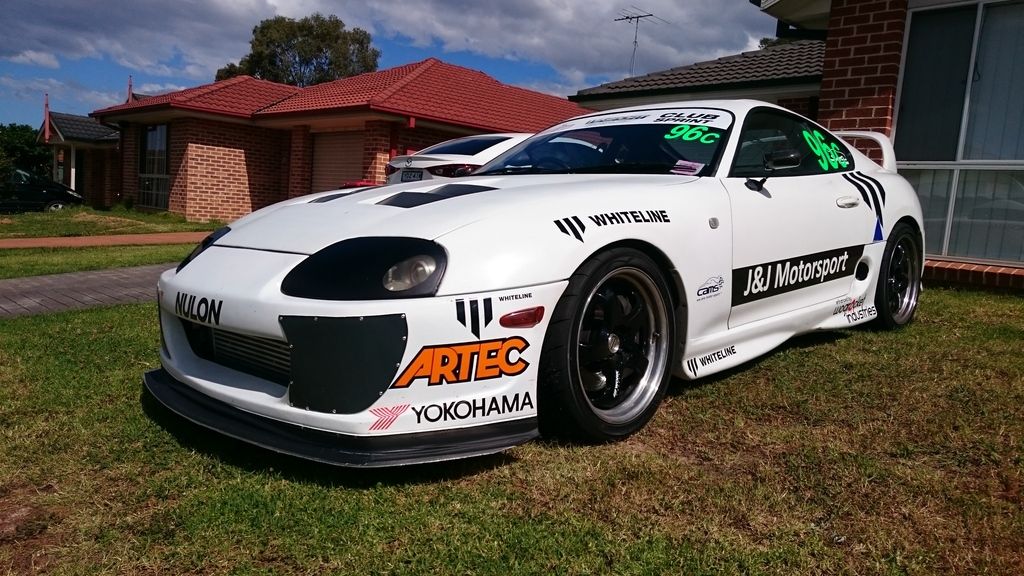

    Seeing ive lost my complete build of this car here we go again.
    ​​​​​​Car
    1995 Toyota Supra RZ
    Exterior
    option side skirts (also have Ridox ones to go on)
    option rear pods
    Ridox front bar
    stock, trd and Vertex gt wing depending on the event
    alloy front splitter
    composit diffuser
    gutted headlight with intake or stock lights
    Wheels & tyres
    ccw c10s
    front 295 rear 295 advan ad08r or hankook semi slicks
    Was on Work Meisters 18x9.5 18x11 265f 295r
    Suspension
    MCA red coilovers sprung and valved for racing
    whiteline sway bars front and rear
    whiteline hd adjustable links
    front and rear strut braces
    Engine
    2jzgte 3L turbo
    gtx3582r 1.06 t4 rear
    gcg manifold (will replace with 6boost)
    turbosmart 50mm pro gate light
    custom 4" dump custom screemer
    4" artec straight through titanium exhaust
    artec 4" intercooler
    Heads been rebuilt with minor work
    Hks 264 cams
    kelford valve springs
    custom cam covers with welded fittings
    custom catch line with braided lines
    billet cam tensioner
    turbosmart Eboost2
    Haltech ps2000 ecu
    Haltech 3bar map sensor
    1250cc top feed Bosch injectors
    billet fuel rail
    Turbosmart 1200fpr
    Walbro 460 fuel pumps X2
    wogrocket 247 1/2" hard lines
    inline filter
    e85 fuel
    19 row Oil cooler
    grex oil filter relocation
    powersteering cooler
    all new oil and water pumps
    carbon air guide
    Gearbox and diff
    v160 6 speed manual
    Orc 750 twin plate clutch
    Pull push converter
    ​​​b series diff (bigger of them)
    Interior

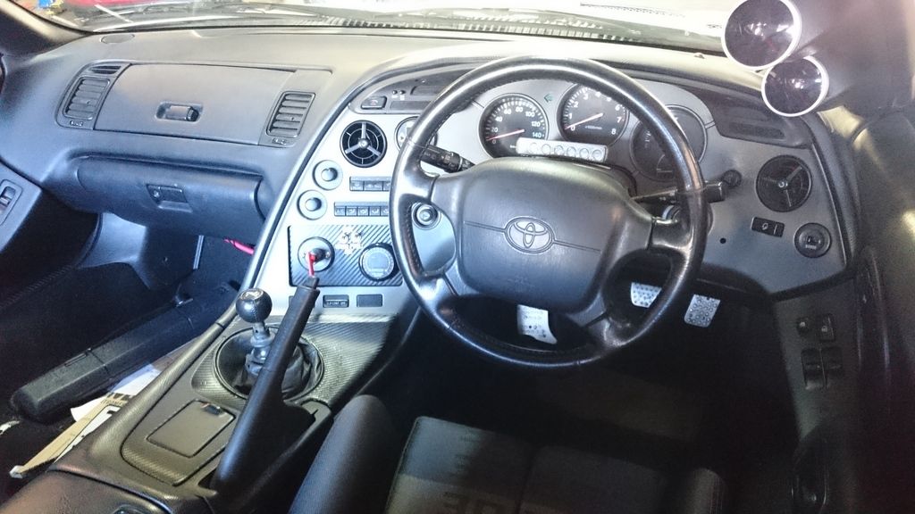

    stripped back interior
    agi half cage
    Bride low max carbon seats
    kill switch
    fan and fuel pumps switch's
    defi oil temp and pressure guages
    1kg fire extinguisher
    battery in back seat area
    Power
    Secret but made over 400rwkw at 22psi
    so you can do the math
    tuned at crd
    ​​​​​​was tuned at another shop and had nothing but issues including low power high Oil temps blah blah blah
    special thanks to sponsors
    J&Jmotorsport
    nulon oils
    whiteline suspension
    Artec
    Wogrocket industries
    and previous sponsors
    gameon motorsport
    Unique automotive
    WIDE LOW FAST AND LOUD
    96 Toyota Supra T78 track build/ daily (see members rides)
    Some more pics coming and some extra details
